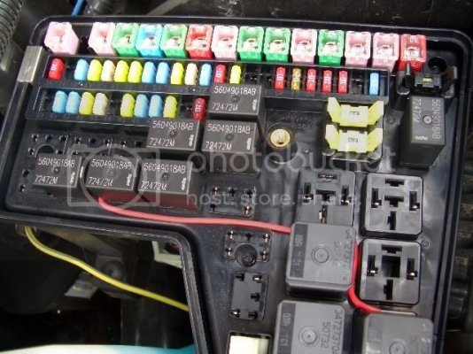

I don't know how that's possible, besides the fact that I've personally been under the hood of about forty '04 & '05 Rams and have looked right at the PDC & FCM, I read first hand on the StarScan Tool screen yesterday "TIPM - 2006> models".
What you are saying is if you pop the "fuse box" cover under your hood, you have NO relays for light functions?
'04 PDC (note there are relays for lighting that are absent in '06+ models):

The way it was explained to me, was that up through '05, it was a separate PDC (Power Distribution Center) & FCM (Front Control Module) and in '06 they combined them into a TIPM (Totally Integrated Power Module).
The lights, whether they be headlight, fogs, running or tails are physically controlled by traditional fuses and relays in the pre-'06 Rams. You can tell this by seeing them in the PDC.
With the integration of the two units in '06, they are electronically controlled by the TIPM. This is evident by the absence of relays for the lights. (You'll notice a lot of posts over the forums by '06+ owners asking where the relays are when they have a light out and they attempt to check the relay, because there are none).
The price for the PDC & FCM combo is about the same as a TIPM from the prices I'm seeing, so I don't think you got hosed. It's possible some call the older setup a TIPM as well. It is apparent that the StarScan Tool only recognizes the '06+ as a TIPM or at least a model that it can program.
Regardless of whether the pre-'06 set is called a TIPM or not, the bottom line is that the StarScan is set up to communicate with the '06+ TIPM and not the pre-'06 setup. It appears that the only way to make changes in the older setup is to PHYSICALLY do so by wiring the relays by hand. Whereas, in the absense of relays, you have a set of controls over lighting that can be programmed via the StarScan, meaning it looks like I'm going to either have to do some creative relay wiring or just run the wire and install a switch for my off-road lights.

, UUUHHHHH LOL not sure what you mean about the relays, but last year i plugged a grounded out boat trailer, no lights worked and all fused were good, Dealer replaced TIPM I have the $830 recipt, unless i got royaly fukked
Anothony,
The 04 service manual I have states it uses a Integrated Power Module (IPM). Your dealer may have mis-wrote your work order, but if you have a 2004 medel you do not have a TIPM to the best I can tell from the 04 manual.
