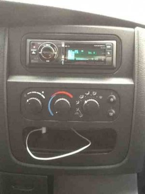

I agree with the clean look of a stock deck but I picked up this kenwood bt952 off of crutchfield for $200 with all installation gear and it was well worth it and looks super clean. The sound quality is night and day difference too!
