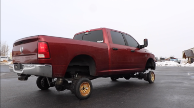

Whats your perceived wheel travel now?
You could downsize your tires for extra perceived wheel travel, whatever that means.

It was a nice way of saying that I think trucks with the biggest tire possible stuffed in there look like crap. I like having 7-8” of gap from the top of my tire to fender.
i see, here you go, perfect fit for the style you're looking for, max fender clerance and LOOKS soooooo gooooooddd as it's not stuffed ....
