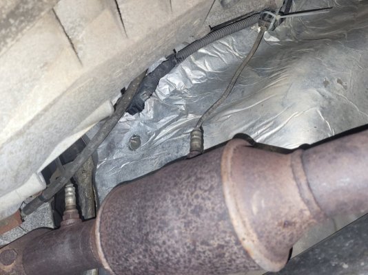

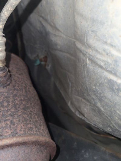

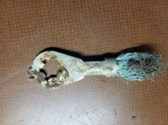

So I noticed my ground strap on the passenger side by the exhaust of my ram was rotted off. i took the strap off but the stud was rotted off too. i am fairly sure this is why my lightning bolt was flashing. i went to replace the ground strap with a used strap off a 2002 ram 4.7 from a junk yard. the ground strap was the 2 pieces with one being considerably longer. the end on 1 side had a smaller inner diameter spur like, just like the one pictured and the other 2 ends had large openings that would go on the back of the heads.

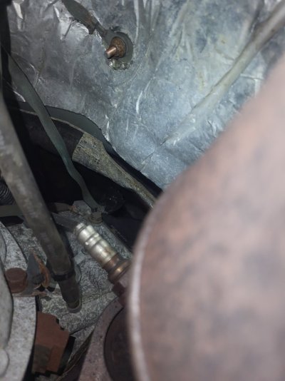

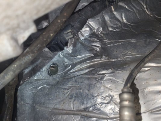

the rotted off ground that was attached by the passenger side exhaust had the smaller inner diameter connection that looked like a spur so i decided to use the same end off the used strap to connect to a different ground stud by the passenger side exhaust that is pictured. i tried to sand the area but couldn't get anything up there to sand it with.
is the stud being metal enough to ground it or am i going to need to sand the paint off where the floor is? i also wrapped the other section of ground strap, zip tied it and put tape over it because i didn't know if what i did was going to work yet and i don't want to cut that section off since i don't have a way to crimp the wire back to the connector if this way i rigged it doesn't work.

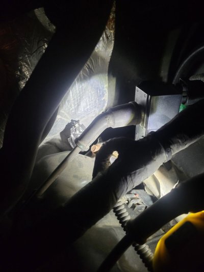

Did I do this all wrong or is this fine? i also routed the strap to where the strap touches bare metal on the transmission since the strap is so long. is this bad?

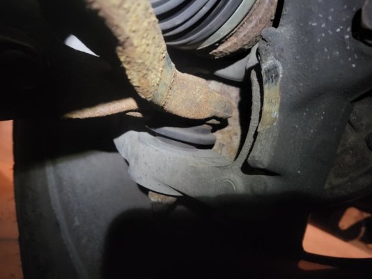

also noticed the spindle? is hitting the control arm when at full lock? is there a way to adjust this or will an alignmet shop have to fix it? it is on both sides?

Buy or build yourself 2 ground straps,run 1 to an alternator mounting bolt,run another to a bolt on the engine or exhaust manifold,and hook the other 2 ends to the negative post on the battery,or to the post on the cab the negative off the battery connects to.
A couple short lengths of 10G wire should be all you need,crimp whatever connectors you need on the ends ,usually a ring terminal in the proper size to go over the bolts or studs you're connecting to is all you need.
Not much to grounding the engine.
