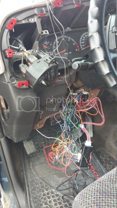

So I've purchansed an Avital 4103 remote start/keyless entry system, its a bit beyond anything I've done before on a vehicle although really I figure worse case scenario I blow some fuses and have to reshrink wrap and solder some cables. Needless to say I'm still quite a bit nervous about cutting into and messing with any wires on my truck let alone ignition wires. That said, first thing I'm going to do is a walk through talk through, as much for myself as anything, on where all the wires are going to connect. I have a 01 Ram 1500 Wiring diagram that I got from the forum.

Obviously a lot of these wires I won't need for the remote start, for instance my truck doesn't have an alarm or at the very least if it does I don't know about it, don't use it, don't intend on using it and am thus not worried about it. I also won't be messing with the windows, I'm not a diesel, I don't need the driver/passenger door triggers, I don't technically need the tach since the Avital 4103 has a virtual tach (no clue how that works something about recognizing an increase in voltage that signals the alternator has started) but I might install it anyway, if I can find the wire. I'll post up a picture of the system and its install instructions that accompany it so you can follow around, and check my work if you so desire (please do so, a second set of eyes and minds never hurt). The complete install instructions are at http://www.directeddealers.com/manuals/IG/Avital/N4103_2008-07_web.pdf
Main Harness (H1)
So the H1/1, H1/2, H1/3, H1/4, H1/5 won't connect to anything (decided if I'm just going to cut the wires and then electrical tape them.
H1/6 will connect to the horn trigger Black/red wire in the steering column harness
H1/7 Not used, its for trunk release, I imagine you could use it for something, but I haven't a clue what you'd use it for on our trucks.
H1/8 Ground wire, I connected mine to a factory screw to the metal frame of the underdash.
H1/9 Parking light Black/yellow wire behind the headlight switch(wasn't as hard as I expected to get the wire up there, but people keep telling me you can access it under the dash, I just never saw where)
Heavy Gauge Relay, 6 pin Connector
1 12v Ignition Wire Dark Blue in the Ignition Harness
2 Starter Wire Yellow in Ignition Harness
3 Accessory Black/White wire in Ignition harness
4 High Current 12v Input Red wire Ignition harness
5 Second Ignition Black/Orange wire Ignition harness
6 Hich current 12v input Pink/Black wire Ignition harness
Remote Start harness (H3)
H3/1 Neutral Safety Switch Connect to toggle switch and then grounded
H3/2 Tachometer meter Black/Gray in ignition coil in engine compartment (or left out if using virtual tach, which I am)
H3/3 Brake white/tan wire at brake pedal switch
H3/4 Hood Pin Switch somewhere in the hood (or not at all, it isn't strictly needed, just used to shut down the system if the hood is open, I chose not to install it as they have a lot of issues with corrosion)
H3/5 Not needed
Satellite harness (Completely not needed but you can use it to hook up other accessories, I haven't a clue what you'd do with it but hey you can do stuff.)
1 status output
2 2nd accessory output
3 Second starter
4 3rd ignition, don't have a 3rd ignition
Door Lock 3 pin Connector
1 unlock 5 pin relay 1 pin goes to the pink/purple power door unlock wire in the drivers kick panel
2 empty not used
3 lock goes to 5 pin relay 1 pin goes to orange/purple wire in drivers kick panel
