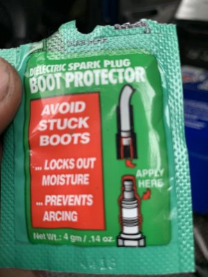

I’m at work so idk how much time I can play with her. Thankfully tomorrow is Saturday. Someone’s gotta go in but it won’t be me! Anyway I digress; I pull the cable from cylinder 2. Spark end I might’ve pulled off on removal. The distributor end has some fluid. Can’t make out the smell. But I think it’s just this. upload_2020-7-17_9-23-12.jpeg
