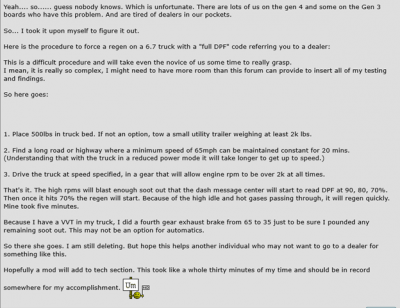

I had an issue where my DPF system failed to regenerate even after traveling at high speeds of 75 miles per hour. I am here to say that the below steps do work. I connected my 6,400 lb toy hauler and set my speed between 55-60 mph. Plenty of WHITE SMOKE was released and the system regenerated. I traveled approximately 5 minutes and had no issues thereafter. Who ever posted the following instructions, or if you know who it was, THANK YOU. This saved me a very expensive trip to the dealer.
