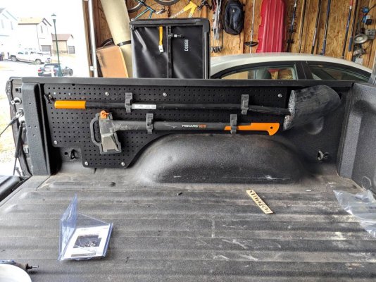

Those L-tracks are pretty cool. I considered installing them too, I ultimately went another direction and ended up doing this:c079b61484e53db953536a6ea1900c59.jpg

Bryce88,
How did you secure your 'pegboard' to the bed sides ? I can see the bolts, but how do they anchor to the bed ?

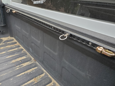

I installed the L track from US Cargo control on the front of the bed rail and along the sides (inside of the tail lights) in black. Company is solid and shipped fast.
I used a simple metal step drill on the bedliner to sheet metal holes. Cleaned them up and put some paint on it to reduce rusting. Then blue lock tight on the bolts and I used black silicone on the top and sides. 20191222_095923.png 20191222_095927.png 20191222_095939.png

That looks awesome, man. So did you use rivnuts to bolt to?

No, with the taillight out I could get to the back of the panel. On the front of the bed, against the cab I could get behind it with my hand and a socket.
