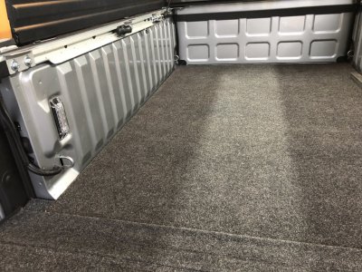

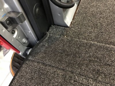

I have a 2019 ram 2500. I bought the regular 6‘4” bed rug. It is not the complete bedliner it’s only the piece that fits on the floor. It works well and is pretty easy to do. Just use a straight edge and a box cutter. Just be careful on the rear corners you have to cut it 90° to fit the stepped area just ahead of the portion that covers the tailgate. I’ll try to remember to post a photo when I get home.

Looks good. So the ribs on the floor lined up. I know previously when I had a bedrug in my ‘03, that was of my favorite things. When you crawled around on your knees, the floor was almost completely flat. No ribs to dig into your knees.
