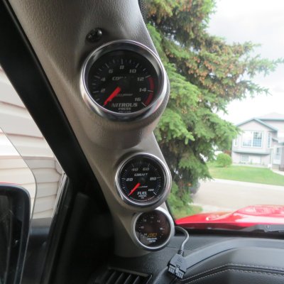

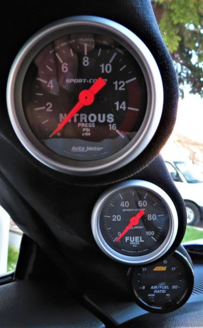

I had AEMs in both the car and truck,and the trucks gauge is going on 10 years old now with no issues.

I 'assume' I would need a wideband for my truck?
If you were to go ahead and start making changes with HP Tuners and you didnt have a wideband in the truck then you would not really be tuning. That would be more like making blind changes and adjustments to the point where you are no longer tuning because you cannot see what the results of your changes are. If you are serious about learning how to use HP Tuners and do it effectively then a wideband is a MUST. Flying blind is not fun and the "seat of the pants" feel of things and the "butt dyno" do not work very well.
Spend the extra money and get yourself a quality wideband so that you can see your changes and learn what those changes did to the AFR.

Oh, I knew I'd need a wideband for tuning, I was questioning if the truck already had one. I kinda figured it didn't but it never hurts to ask.

Yeah, no worries. The factory oxygen sensors are useless for tuning AFR because they are a narrow band sensor.
