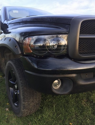

Oh ok I didn’t realize it was a second gen truck. You can still do a retrofit in them, same principle. I don’t know if any aftermarket housings to recommend though. Hopefully someone else will. 864423869623a37a957edc1de2f59df4.jpg

Hey, Chris. Know how to solve the issue of the 3rd gen stock housing bulges and lines?
-Buy aftermarket heads
-Remove flat, lineless lenses
-Put ugly stock lenses on
-Return aftermarket heads
-Attach flat, lineless lenses to stock heads with whatever retrofit parts and paint you want.
-Profit.
Sent from my magic 5-inch

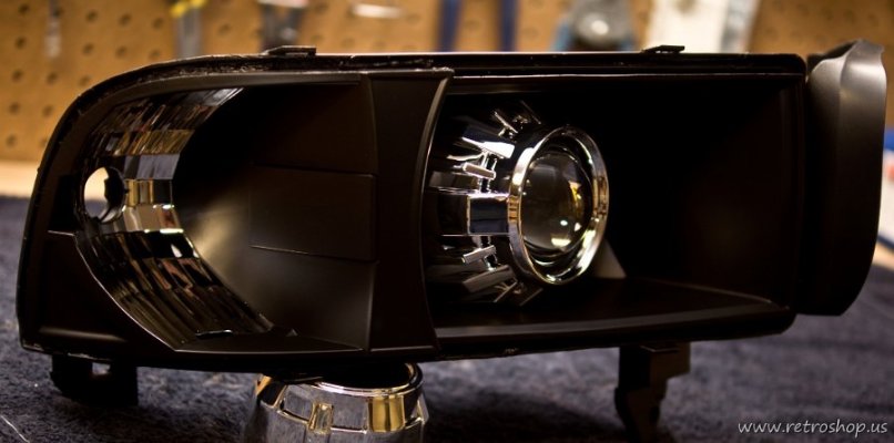

Been doing HOURS of research since I started off knowing zero. Learned quite a bit about lights and what I need.
I found out theretrofitsource offers built projector lights with options available. I didn't check them out at first cause I thought they only supplied the parts for DIY retrofits. VERY happy to see they do builds :)
I'm gonna buy some prebuilds from them rather than struggle with doing it my self. At least I know everything will work together and is put together correctly.
I'm looking at getting Tyc lights w/ Morimoto HID projectors.
Maybe even them morimoto switchback halos are in order.
Now I'm getting hooked on cool looking lights. Once I figure out what the heck Demon Eyes are I might get some of them too. Do they light up as parking lights or when lights are on?

Figuring on ordering this kit tomorrow from RETROSHOP...
2nd Gen Dodge Ram HID Projector Retrofitted Headlamps
Gonna go w/the larger optional projector/larger shroud with Morimoto switchback white/amber halo.
For some reason I thought they used Tyc lights but found out they are Spyders used by retroshop.
Any thoughts on what I'm planning to get?
I'm pretty sure I made the right decision

You will love them! I “think” that’s Jeremy’s shop, he does excellent work and is highly recommended around here.
