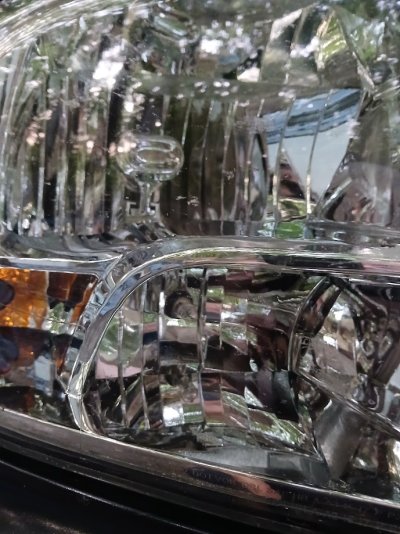

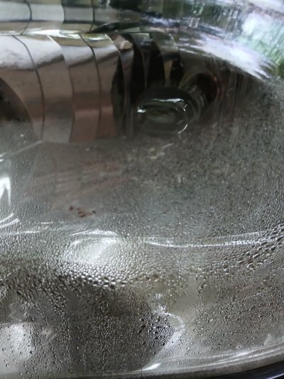

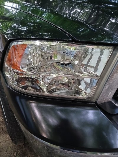

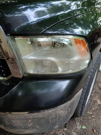

I dont know if I have what theyre calling Factory Quad or Dual Headlights, so I included pics of what is on the truck at this time.

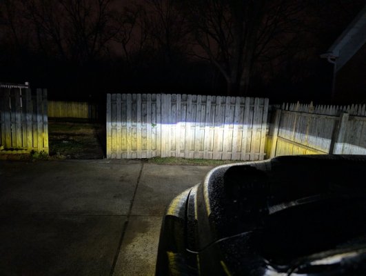

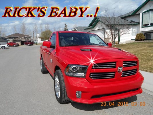

You have the Quad headlights. Projectors look like this.

You have the quad headlights. Mine is a 2014 with the same. They were in excellent shape except for film on the inside. I cleaned them with distilled water/alcohol and a touch of dawn. Looked as new when done. I then put in an LED conversion and wowser it was like going from 1 candlepower to 1000 candlepower. Do be aware the LED conversion can cause some Alpha ODB issues. I bought the cable and Alpha program to change mine to LED. Some newer led conversions say not necessary :rolleyes: but I did mine. Possibly a few others will pi:cheers:pe in

Certain aspects of upgrading to LED bulbs are often misrepresented, such as to say Quads of Duals don't function well with LED or that all LEDs have dead spots.
I would say that both these details may have been accurate in some instances years ago, but the LED technology has been advancing rapidly in recent times.
Sure, Projector housings might provide better light dispersion, but installing the correct LED bulbs in whatever housing you have should prove to be a spectacular improvement.
And, I have worked with several members who have been very pleased after LED upgrades in both Quad & Dual housings.
While HID lighting is tough to beat, you have to pay for that with additional costs, a shorter lifespan and more complications of additional wiring and a ballast module to mount.
There are many threads created by members who have corrected and solved the condensation issue. I wouldn't ditch your Quads without making an effort to fix that problem first.
When I first started buying Fahren LED bulbs, the typical light output was rated at 8K lumens. I could see the difference when I upgraded by 2K lumens.
I currently use 10K lumen Fahren bulbs in the low beams and 15K lumen Auxito bulbs in the high beams in the OE Projector housings. They are insanely bright.
Fahren bulbs are now available in 20K lumens and more. My only warning about buying any LED bulbs is that they're not a standard size; be careful to choose a bulb that has been reviewed here or elsewhere by someone who has installed them successfully in the same type of Ram housings.
Fahren manufactures a couple of specific bulbs that are a lower profile for installation in OE housings with less clearance. Many members have been surprised to find that the OE back covers would no longer fit after installing the wrong bulbs. Then they buy new and deeper back covers. Mine are still the OE covers. :cool:
I would explore correcting the condensation problem and then try out a set of these Fahren bulbs.
At $32, that's not a huge gamble. They used to be warrantied for 3 years if you registered.
Be aware, you may find a better deal on a 4-pack to change both high & low beams.
You will want both to be LED.
If you don't want to deal with the condensation problem, how about looking for Projector housings at a wrecker?

On finding the leak, I would try very low air pressure 1-4 lbs, the lower the better as you are dealing with plastic. Once pressurized if you can't feel the leak, Try spraying soapy water all around the lens and housing. You can also submerse it in water if you have a big enough container.
Once located thoroughly dry it and use a vacuum cleaner to create a suction inside and apply your sealant of choice to the leak.
The suction will draw the sealant in if it is not to viscous, preferably a flexible sealant for plastics. Once sealed do the DI water, dish soap, Alcohol clean (see YOUTUBE). Let them dry thoroughly as there are a lot of nooks and cranny's. Or buy new ones. After cleaning My quads are awesome with LED's.:cheers:
BTW The DI water is critical to eliminate water spots
