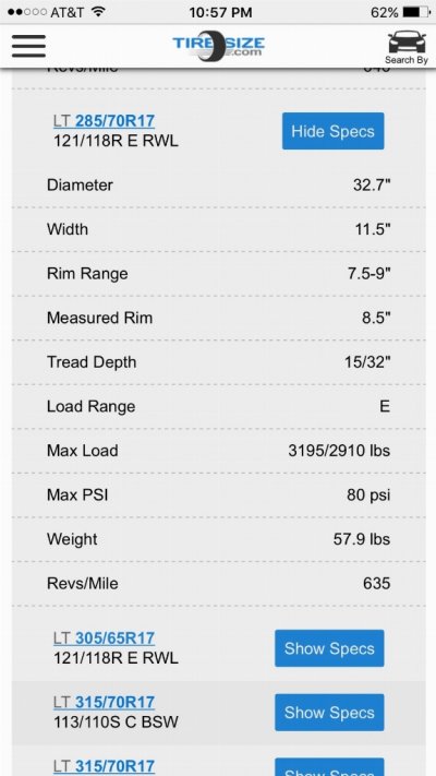

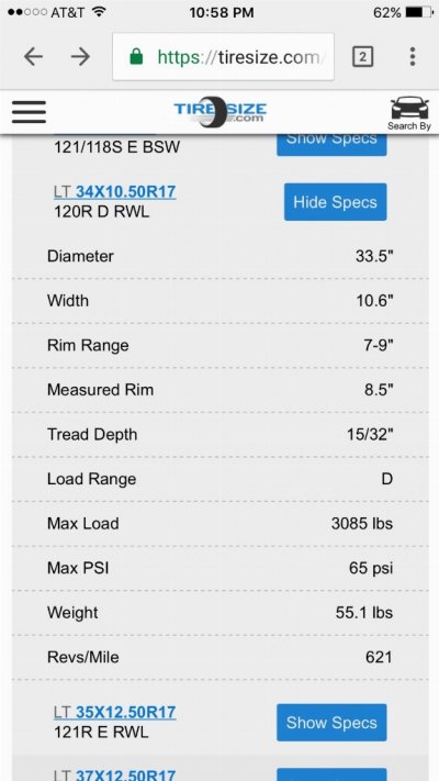

what size is a 34 by 10.5 by 17, 285?
It's not 285 70 17. It's actually 34 10.5 17. It's about 1" taller and a tad thinner than the 285

I'd never seen that size before, but I looked them up, and BAM BFG does make a tire in that size.
I'm not running those, but just ordered 285/75/17s (about 34"x11.2"). Nothing to report yet, but I'm sure you'll clear easily with a level.

LT 285/75R17
121Q E RWLHide Specs
Diameter33.9"
Width11.3"
Rim Range7.5-9.5"
Measured Rim8"
Tread Depth20/32"
Load RangeE
Max Load3195/2910 lbs
Max PSI80 psi
Weight62.2 lbs
Revs/Mile
This is for the K02 MT
Iam guessing that 34x10.5x17 is a all terrain as I did not see it in the list I was looking at. ?

LT 285/75R17
Diameter33.9"
Width11.3"
Rim Range7.5-9.5"
Measured Rim8"
Tread Depth20/32"
Load RangeE
Max PSI80 psi
Weight62.2 lbs
Revs/Mile
The specs I posted are for AT's
