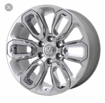

I'm getting a rough country level kit put on my 2020 Laramie 4x4 on OEM wheels (pic below). I am told the biggest tire I can run is a 275 65 20. I was hoping to run a 285 65 20. I know the factory 22"s run 285s, I guessing those wheels have different offsets. Does anyone know how big a tire I could run or if RC .25" Spacers would be enough?

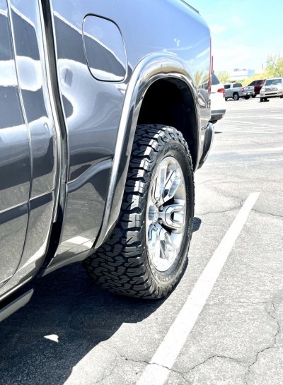

I have your exact truck with the same OEM “sport” wheels. I just installed the RC leveling struts also. I bought BFG A/T K02’s. 295/55/20. They fit fine, Discount Tire had no issues with the rim width (9” I believe). It looks great. I’ll attempt to post pics.
