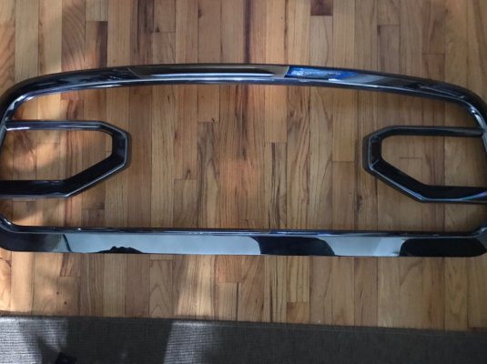

Hey guys,

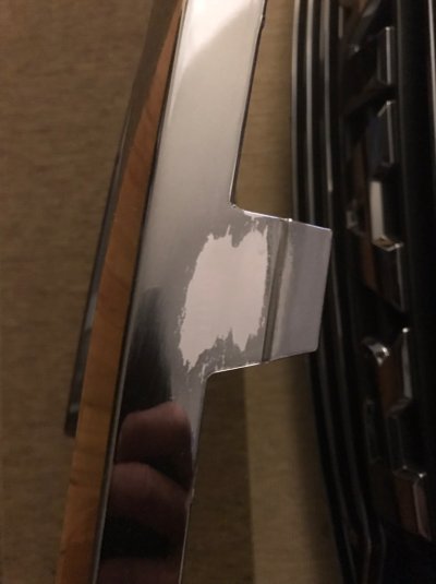

I bought this grille for my bighorn from a friend. I’d like to have a standard chrome bezel, with black chrome inserts — to tie in my black rims and chrome bumper. I tried every way I can think of to safely remove the black coating, leaving only the standard chrome (2nd Img). Alternatively, I’d be just as happy trading bezels for a standard chrome, leaving me with chrome outer and black chrome inserts; and the inverse for the other. Any input is appreciated.

As seen in one of the img, I was able to remove a bit of it, I tried acetone, heat gun (trying not to destroy the chrome). Some did come off, but I have not found a solvent for it.

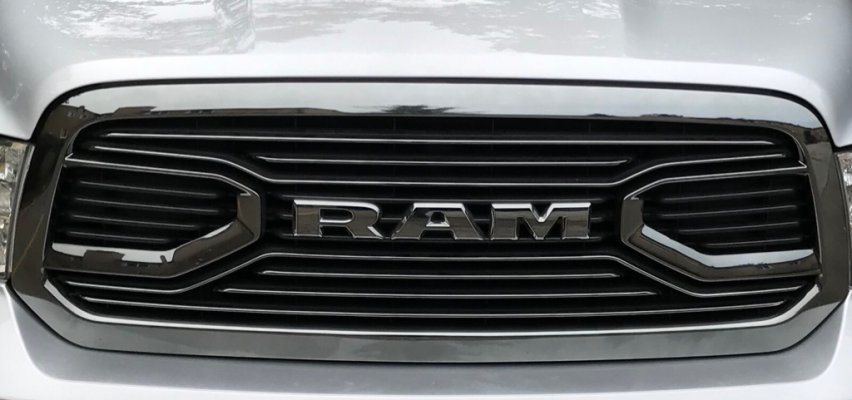

Welp, here it is. Stripper worked amazing well. I could audibly hear the breakdown — sounded like rice crispies in 3 minutes.
Voila! It’s tungsten edition (black chrome) grille insert with standard chrome grille bezel.
Two body shops said it couldn’t be done.
