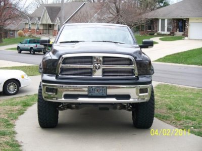

Bryan, here is a picture of BigHorn 4 Life's truck. He has the "gunsmoke" shade on his heads and fogs. This is so you can get an idea how dark it will be.

BryFry...here's the deal:
A lot of people don't like a layover type of tint because it's a complete pain to use on compound curves, like the rounded fogs posted above. HOWEVER, our fogs are almost completely flat. Like Jeremy said, it took me 15 minutes from the time I went into the garage to the time I walked back out...both lights done.
What you want to do is:
Clean the lense thoroughly.
Use a spray bottle to mist the back of the Lamin-x with water after you peel the backing off.
Use the spray bottle to mist the fog thoroughly as well.
Lay the Lamin-x on the lense and, since you used water, you will be able to slide it around to get it in the right position.
Once you have it in the right spot, take a credit card wrapped in a microfiber towel to squeegee the remaining water out...it's not imperative to get every last drip out.
Now you're done...just let them dry and you'll be good to go.
I used the darker "Gun Smoke" and it looks amazing.
