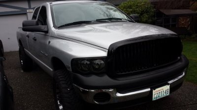

Overheated on the way home from getting emissions done. Tried to stop, let cool down. Blew the motor 3 blocks from my house, 115K on it.
Trying to replace the engine, get a little more power, in as economically as possible. Way too much time on these forums lurking and on Amazon and Ebay. Here is what I am in the middle of doing:
Rebuilt 5.7 hemi longblock
had the 6.1 mopar cam and springs put it in $2700
New radiator - $130
New water pump - $70
Power Steering pump $60 (it was leaking a little, might as well...)
New mopar intake manifold - $300
Headers - This was a tough one to find that fits the 2500 and affordable - Flame me, but decided to try these cheapies I found $170: http://www.autopartswarehouse.com/s...pwcid=gglpla&gclid=CLuKrJvYm84CFU1ufgodPwcEvw
New idler and pully set/belts - $75
Flowmaster Super 44 dual exhaust - ebay $200
Exhaust tips - $50
Spectre cold air intake - $150 Spectre Performance 9932 Air Intake Kit with Red hpR Filter for Dodge 4.7L/5.7L - Plan on buying a K&N and rotating the filters with each oil change
Thermostat - $20 - ($55 for a mopar one???) Trying to keep to a budget here...
Plugs (16 ugh. I had just replaced these last year with iridums) Went with the copper ones as many have referenced here, saving me some $$)
New wires - $80 Keeping the coils
Gaskets - ~ $150
Any thoughts, input or critique is welcome.

Looks like you've got everything covered. The cam will cause some issues when you first fire it up but it will learn the cam over a few drives and shouldn't be an issue unless you disconnect the battery for an extended period and it needs to relearn the parameters.
