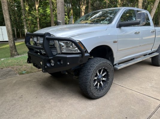

I have a 14 limited, former air ride (now deleted) with 6 inch BDS and 3 inch body. I have not had issues with it other than a rattle that turned out to be the steering box bolts loosening up. That was a bit of an issue with my installer as you might imagine. I run 37 inch Toyo’s and no rubbing.

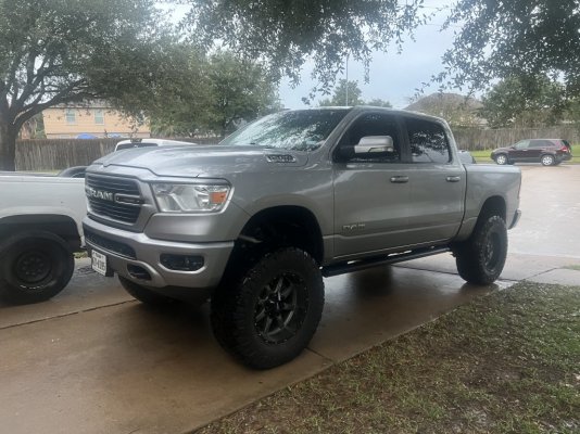

2020 lonestar 1500 on 38s. Compounded rough country 6in with motofab 2.5 level in front and 1.5 in rear.
