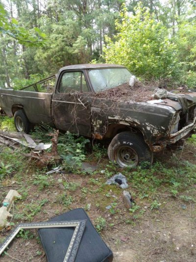

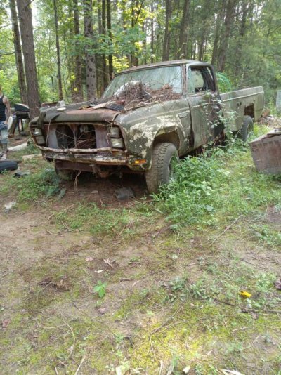

This is what is left of the powerwagon

That may not be a '79.... since it has locking hubs. It better have (or had) a 318 or 360 for the transmission to fit. You will lose your overdrive.
Fuel tank fitment is likely an issue. Use the tank and crossmember from the '91.

You’re right I remember reading about the full time 4x4. Np205? Maybe they swapped it‍
Fulltime is np203.
The 5lug pattern changes between fulltime (5x4.5") and part-time (5x5.5"). See if the rear axle matches wheels.
What you might have there is an '80. That would explain the older fenders and part-time axle. The tcase would likely be the aluminum np208.
