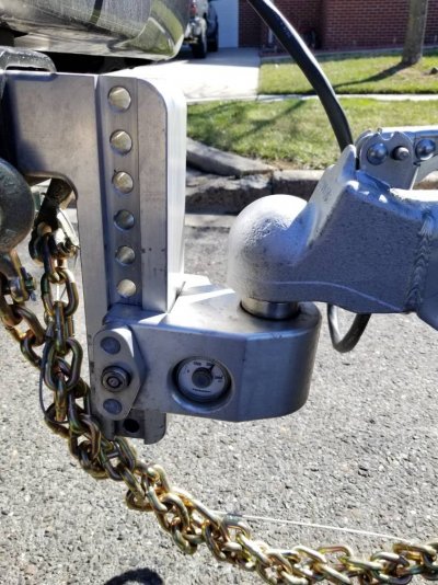

I use this weighsafe hitch. It works great for easily adjusting tongue weight. Highly recommend.

Yes, it really is genius. I'll never use anything else.

I'm half way there to buy one myself. They are awesome, and come in 1400TW/14k weights! And most of them you can choose your shank drop! Very, very handy.

Yes, I've had mine for over 2 years and have never taken it off. I've towed up to it's max several times. Notice the tongue weight in the pic? My particular one is a 2.5" shank (no adaptor, yay!) and 8" drop. It's cut from a solid piece of billet, so it looks great and the build quality, locking system, and versatility are top notch. It also comes with two balls.
