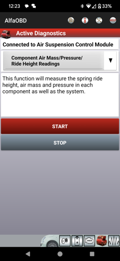

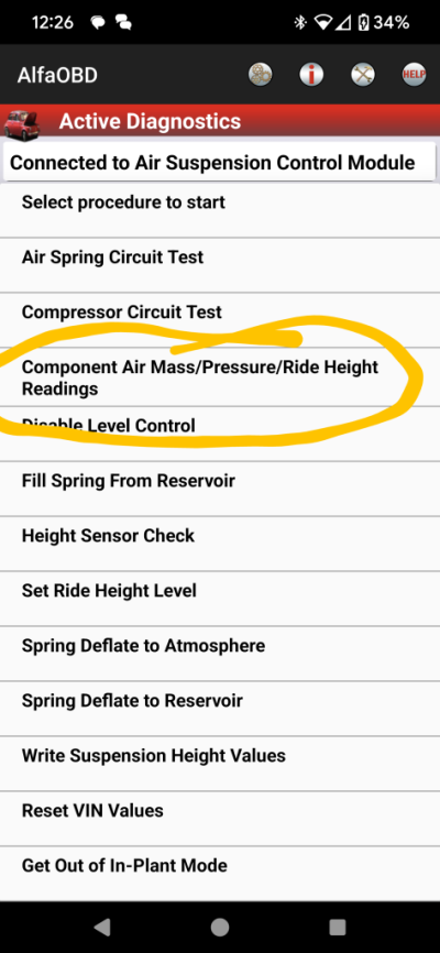

Anyone ever try to use Alfa to see ride height and pressure in system. As soon as I try the system goes into in-plant mode.

You're going to need a dealer visit, they have to purge the system W Vacuum and recharge with nitrogen, make sure they change the moisture filter.
