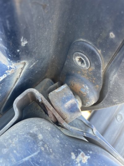

Hit a big dip at the ranch and found the passenger side of my tailgate hanging off. Looks like the metal hinge (the circular metal part attached to tailgate) popped out and is tweaked. Now any little bump without my ghetto temporary remedy (pictured below) and that side of tailgate will jump off rectangular hinge on bedside.
My original tailgate is a bit beaten up (truck just hit 428k miles) so am wondering if an “upgrade” would be worthwhile instead of repairing. I see that a 4G tailgate fits…is it a direct swap or do internal parts (latch, handle, etc) need to be changed? What about a 5G 3/4 ton tailgate - same question. Seems that there are a lot more used 4g and 5g tailgates available these days.

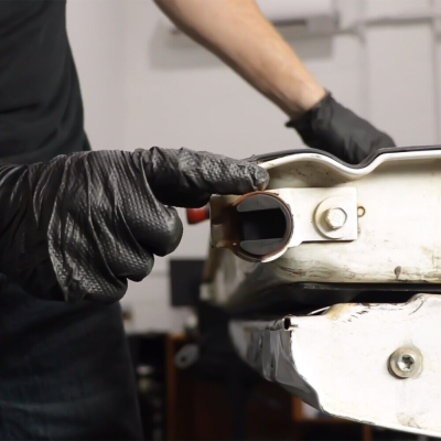

Dodge & Ram tailgates slide into place by sliding the Left side first.
Then while holding the tailgate at about a 20 to 30 degree angle, slip the right slide it into place.
Then it can be lowered or lifted into position.
People have taken something to make a collar or sleeve, that will not allow that right side piece to jump out of position.
Could you take a pix of the part that jumps out of position ?
a video that may help
I’ll get a pic tomorrow. The part that’s broken is the circulsr piece of metal that’s welded to lower passenger side of tailgate and houses the bushing. The bolt on hinges attached to body appear to be ok but haven’t looked closely.
Current tailgate has some dents, plenty of scratches, and the tailgate spoiler is held on by over a dozen sheet metal screws because got tired of replacing them after getting ripped off by a forklift and/or pallet.
Good stuff though…the tailgate has slid off passenger hinge several times over the years, usually while trying to close with an overstuffed bed.

Doesn’t look as bad as I thought…perhaps an easy repair?
And here’s the the truck…not pretty but not especially ugly

What are the possibilities of the bushing being worn out and/or the tailgate latching assembly not holding tight?
Either of these conditions might cause the tailgate to be more prone to spontaneous ejection. :cool:

If it happened to me, i would find a welding shop or an acquaintance with a welder.
Drive to their location, show them the damage & ask their advice.
I think that they would pull the tailgate, bend the damaged part back into position & weld it into place.
Then you can do a bit of sanding & spray it with Primer & then find a similar paint to sort of match the rest of your truck

You sir were reading my mind. That looks like it would weld up fine. No need for a new tailgate.

Well…the bungees kept the tailgate on the truck, but now that round hinge has broken off the tailgate and gone missing. Had an appt with my local machine shop tomorrow to get it fixed…is that part available separately to spot weld on, or does it only come with a tailgate? I should’ve taken the damn tailgate off yesterday…

they do sell the part that fell off, it is called the tailgate pivot bushing1711419873776.png
Mopar Overstock is one OEM seller
Dorman parts is an after market seller
2002 - 2008 Dodge Ram 1500 & Heavy Duty models 2003 - 2009
