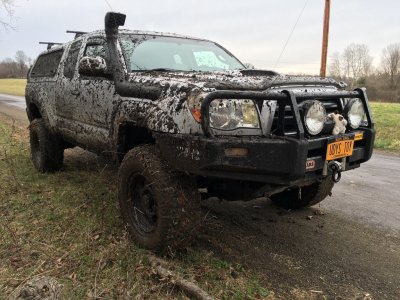

You may want to look into a plate or tube style bumper instead of a grill guard! On impact, many grill guards may bend back and creat more damage than the deer! I’m searching for one myself!
The Tacoma a just sold had an ARB! Three deer hits at 45 to 70 mph...0 damage!
