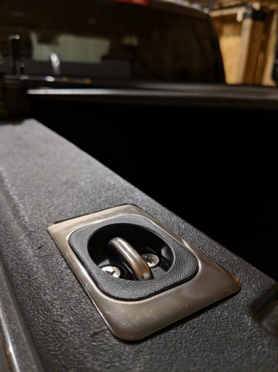

Thanks for the input, folks. My wife gave me the Bullring flush mount stainless steel D-ring tie downs for Christmas (gun metal finish), and I spent a little time this afternoon putting them on the truck.
They are very well made, and installation went smoothly. I got the router bit to help trim the plastic - but I only used it on the front stake pockets, since the rears have the plastic sleeves that run down into the pockets, and by the time you do all the cutting to get that out, the rest of the trimming might as well be by hand. I left it as a 'just-barely' fit in the rear in case I get OCD and ever think the trim job under these tie downs needs to be cleaned up with the router. Since the tie downs cover the edge, I don't think that'll ever happen. I like the look and the function - I'm looking forward to using them !
P.S. I was not sure what "do not over-tighten" meant - I used a 1/4" torque wrench and 360 in/lb (3 ft/lb) on the screws.
