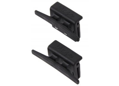

I wanted more tie down points and found these ! They will be here today and are bolt on so no drilling :) Not sure if they will work for you but worth a look ?

I always like those rail mounts , but held off. I really do not want to drill holes in my truck :O That's why I went to those Extang clamps. Buut no drilling needed and rated at 500 lbs and are movable as needed ! I have 6
https://www.etrailer.com/p-EX1932.html
