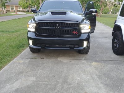

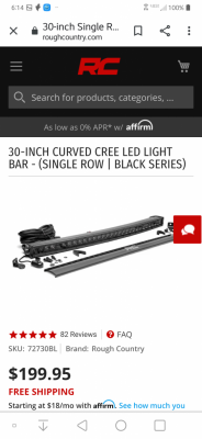

Now I got more questions! Got a link to the light bar?
Are those tow hooks I'm seeing?

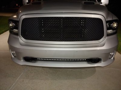

Which grill is that? Did you have it paint matched?

Yes, those are tow hooks installed and yes I had the outer trim piece of the grille color matched to my truck

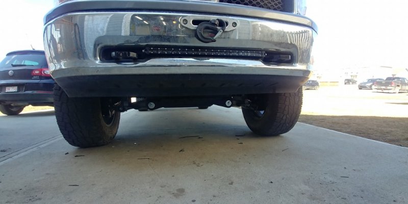

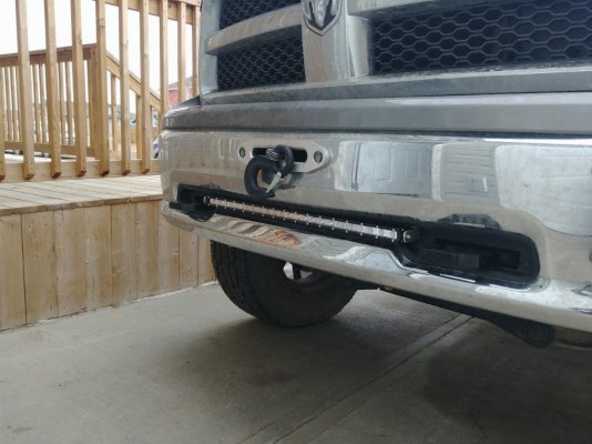

I screwed the Aluminum racket I made right on the plastic .
