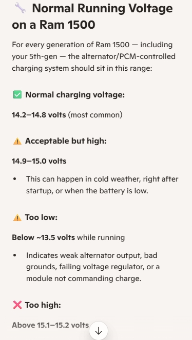

I am leaning towards either the small connector on top the alt, or as someone else posted here, the alt is not charging for a split second on startup -- that makes sense to me....when the light comes on, the alt is charging at about 14.7...when the light is not on it charges at around 14.5.

I had the same issue with a Toyota that was putting out too much voltage. Random light. Finally caught it at 15.1 volts. You mentioned 14.8 at idle. Try checking the output at 2000 rpm.
Yep, did that...never got above the 14.7 when the light was on and 14.5 when it was not---
