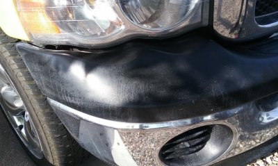

The black plastic on my front bumper has some kind of stain on it. I have tried vinegar, peanut butter, back to black and just about everything in between. Does anybody have a secret to getting these stains out?

Thanks, that is what I thought, may need to just paint it. I never heard of the heat gun. Will give that a spin. Just heat it up a little?
the heat gun trick is you heat it up and you can watch the faded areas go back black, but you have to be careful because you can melt the bumper cap, it pretty much melts the top layer into the lower layers of plastic and pretty much makes it look new again...
the pic you posted the cap looks smooth? normally they are textured if they arent painted

each end is pretty smooth. The stains on each end are under the headlights only.

it looks like something spilled its ass off on it, since you have tried back to black(horrible product) and others id suggest you scrub it with alcohol, that will strip it down to bare plastic, and if there are stains still left behind they are embedded in the plastic, then id try the heat gun and see if that brings it back to a deeper black shine, otherwise, get some plasti-dip and spray it black, will look like new and if it messes up its simple to respray

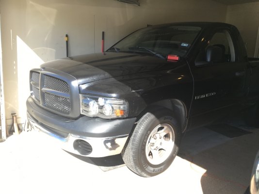

I took this before i did my sport conversion, the bumper cap is a textured black one i did the heat trick on and the grill is a chrome grill with black plast-dip and a coat of dip-gloss, in the pic u can see it matches a black cap pretty well so you could do that to your cap and call it a day

I tried the heat gun, some of it looks better, but I am afraid the rest is too far gone. I see you can get a replacement cover relatively cheap (53.00).
