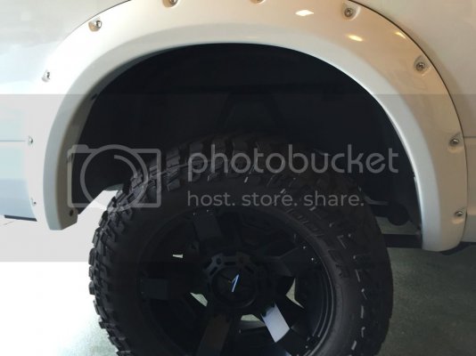

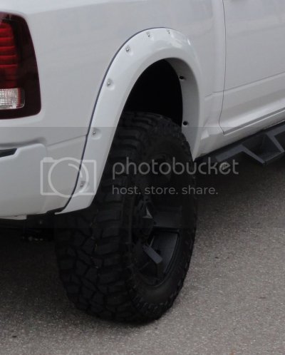

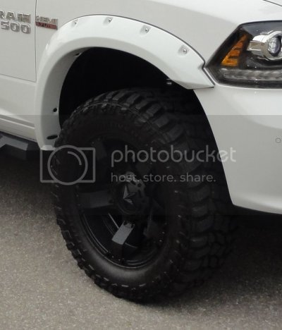

The Bushwacker pocket flares aren't that hard to install. Just follow the instructions. The rubber edge trim gave me some issues. My flares were the pre-painted ones so the edge was already installed...but done badly by some yahoo at the factory. I contacted Bushwacker about it & they sent me a new trim kit that I had to install on my own. The Bushwacker rep told me that on the front flares the edge trim stops prior to returning on the underside of the front tip piece (see orange Ram pic link at bottom of post). I didn't like that idea so I stopped the trim where the Bushwacker rep said to, but then added a small additional piece on the underside portion of the flare (see 1st pic of my flares - driver's side).
When installing the rubber edge trim, using a hair dryer to warm the rubber makes it more pliable to form around the flares...especially the front flares at the front section....there's a couple of zigs & zags you have to get around. The instructions require you to make a couple of cuts with those zigs & zags. There is a pic of the cuts you have to make in this link.
http://www.ramforum.com/f41/bushwacker_pocket_flare_edge_trim_issues_-_looking_tips-89617/
There is a lot of information out there that over time the rubber edge trim will wear into your clearcoat. I was initially concerned about it, but most people don't worry about so I decided not to either...I think it'll take a long time for that too happen & I don't intend to remove the flares. You'll get far more damage to your paint from the wheel well black trim spats that come on the Sport from the factory.
If you're really concerned about the rubbing of the clearcoat, I've read of different solutions to the issue. One guy used black electrical tape under the rubber edge trim to protect the clearcoat. He pulled off the flares after 3 years or so & the tape was hardly damaged at all.
Another option would be the 3M clear film installed under the rubber edge trim. Here's a link to 3M Clear film door protection kit that would probably fit your needs.
https://www.amazon.ca/3M-08582-Door-Edge-Protection/dp/B00650NY6G
You can also buy the 3M Clear film in bulk rolls in varying widths.
Here are some pics of my flares.
  • bushwacker-pocket-style-front-rear-fender-flares-for-dodge-ram-1500-2009-2015-3.jpg

Thanks for the reply, you didnt have to move the HEMI emblem eh? was wondering if that would have to go or not.
probably going to just put them on as i dont think ill be taking them off ever. i think it could make a nice truck look bad if the electrical tape or 3M film wasnt perfectly in line with flare which could be hard to do. *edit* i saw this tape online and was wondering what you thought of that?
Gorilla Tough & Clear Mounting Tape | Gorilla Glue
My flares were originally the unpainted version painted & installed by my dealers third party shop. They did a crap paint job & I'd paid for the pre-painted so that's how I ended up playing with them myself taking them on & off. My Hemi badges didn't look like they were moved, but I can't be sure.
I've heard of some badges that do & some don't. Once you have your edge trim on & your factory wheel well trim off, you should be able to hold the flares in place & see if they fit without moving the badges.
The downside I see with the Gorilla Tape is that if any of the tape is visible it'll be an eyesore that will collect debris on the adhesive. The 3M tape less so. The other issue is that if the foam is not closed cell (water resistant), but open cell, it'll soak in water & that's not a good thing.

so you had to completely remove the front spats? could you take a picture or 2 so i can see what they look like now with the wheel well? im using mine as a work truck and need them there if thats the case.
the rear ones in the back look perfect. very nice work, im sure some auto accessories shop tech would just try and force the flare over the spat piece
Yup the front spats couldn't stay on even a trimmed version. The first pic in the below link shows the Bushwacker flare with the front spat removed.
http://www.ramforum.com/f40/protecting_pinchweld_area_after_removal_spats-87241/
You can see those two bolts are now exposed. I've got that whole area covered in a heavy axle grease to keep it from getting rusted by the winter sand blasting it will get.
