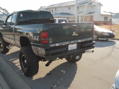

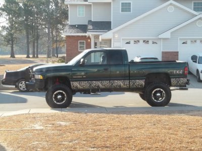

Welcome to the forum, might as well throw the dog a bone and post up some pics of this plaything!

this is my baby, Big Bertha, she needs alot of work yet. I dont have much knowledge of vehicles jsut got a good deal on this figured i woudnt have to get the accesories myself so im hungry for knowledge!!!! i'll be asking all kinds of questions at every bump i hit so thanks for all the help and support.

Nice lookin 2nd gen. I've been kicking the idea around of adding some camo to mine somewhere too
