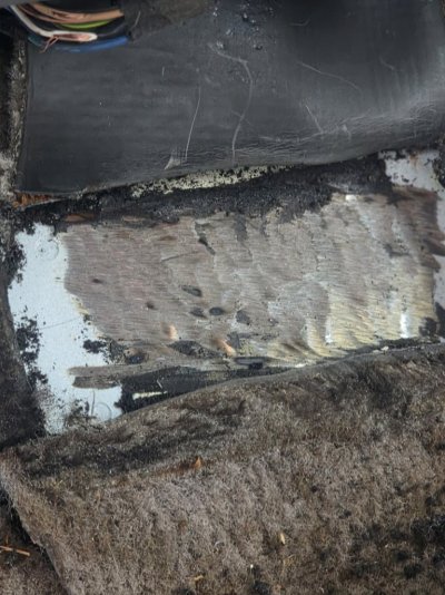

Ok see this. This where the air bag sensor bolted down to the floor board. It looks like that might able to come off. But I dont know for sure.

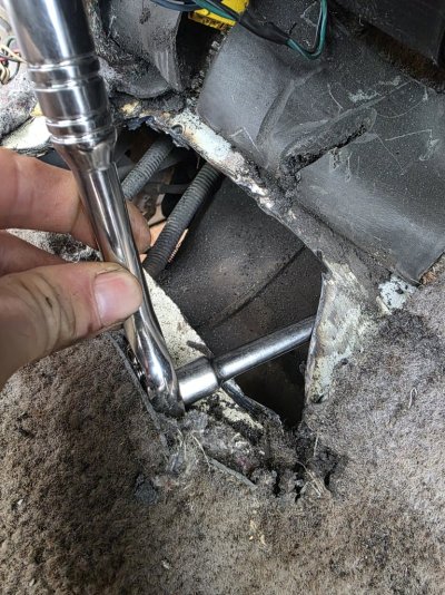

Hi Harley! Any chance you know exactly where i need to put this hole in floor board to hit that bolt?
Looks like there's a lip that hangs down that keeping me from lining up that extension correctly. 1000001785.jpg

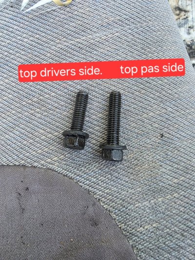

The drivers side. Not pictured. Came out easier for me. But I just kept cutting till I could feel it with a finger. Which was the main one I couldn't get to. The one I took pictures of, I figure you could get from underneath.
Ideally the goal, would be drill a inch hole, exactly lined up exactly where the bolt is. And zip it out with an impact. But there might not be clearance to get an impact on the end of it. Im not sure. But i will probably grind that lip down some when I can reach it. I don't figure it would hurt anything to take that lip down in a spot.
