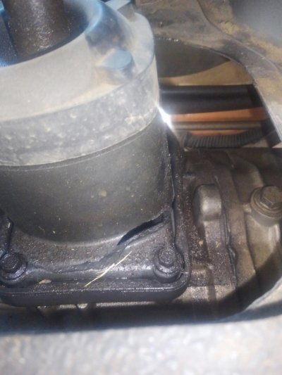

So I got the console out, lifted the boots up out the way, and found this;
I'm thinking, problem solved. Although it does give me reason to worry why there's a bolt missing from the shift tower and whether a new bolt will go back in.
Then I go around to the passenger side and find this:
Suddenly, $300 for an aftermarket shifter doesn't seem so bad.

This is getting frustrating. The dealer can't get the part anymore. Called Allstate Gear and the part number he gave me was for an NV4500 shifter, not the NV3500. Searching by the official Chrysler part number the dealer gave me seems to bring up just the lever, not the entire assembly. About to get some JBWeld and a hose clamp.

Replace the trans mount too.
It looks like P.O. used to let their hand ride/rest on the shifter. That’s no bueno.

Haven't gotten to the junkyard stage yet. Not terribly optimistic about that, but it's definitely on the to-do list. Also considering having this one welded if that's even possible.
The other concern is whether that missing bolt is actually missing or broken off in the housing. That could be a nasty can of worms.

Got the old shifter out. Lots of good news; the gears in the trans look fine, the rest of the shifter looks fine, the missing bolt is not broken off in the housing... I should be able to just bolt the new shifter in place and rock on.
One bit of bad news, I can't get the lever off the shifter. It should just thread on, but I can't break it loose. To be fair, I haven't tried all that hard. I don't have a vise to clamp the shifter down. Might have been best to break it free while it was still in the truck, but with the condition of the housing I was worried about breaking it completely and having debris fall into the trans.
