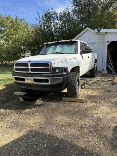

I'll try to make this as short as possible.. I am not very savvy with transmission internals.
98 Ram 1500, NV3500 5 speed manual 4x4
I got this truck from a guy and it was not running. The transmission had a shattered bellhousing so I sourced a new one and put it on the transmission. While I had the transmission halves split I didn't notice any terrible wear on any of the gears or any chunks of metal so I got it all together and slapped it on the truck.
The problem I have is that when sitting at a light/sign at idle, it can sometimes be very hard to get into gear and I mean any gear at all 1-5 and even reverse. When driving it shifts fine can sometimes be a tiny bit harder to get into next gear. But at idle is the biggest problem I am having.
I just bled the clutch recently to rule out any issues there and the clutch kit is fairly new. I'm assuming synchros but it just seems odd to me that it will shift fine in motion but going into gear from idle can sometimes be impossible and it seems to be intermittent.
I'm looking to get some ideas from anyone more experienced so that I can get a game plan before I just go and start replacing things.
