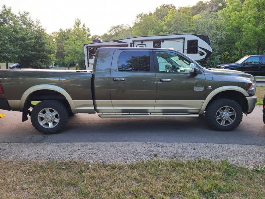

I need to replace the cab lights on my '11 2500 Longhorn Laramie as 1 has burned out and I want to switch to stronger LED from the incandescent. Anyone have good luck with replacing a certain brand? It seems all the various reviews I've read had someone complaining about one or more burning out (?) or them leaking. Need some guidance. Thanks20230718_063326.jpg
