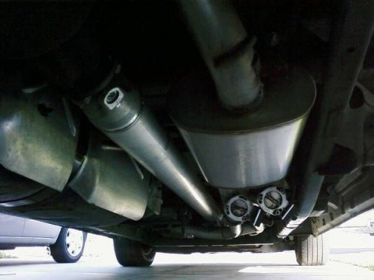

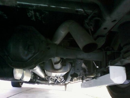

stay away from flowmasters...and here's a exhaust design to consider, true duals to dual in/single out muffler, with h pipe, and cutouts if you like..

if your settin up for performance...choose any other muffler then flows... dumped just means turn downs, mine is dumped after axle, most do it before but that's too loud for me, I did mine after to keep it quiet incab and to eliminate drone... if you run piping out the back, you will most likely get drone... been there, done that... everyone that I know that has started out with flows has ended up swappin them out..

imo, it's the piping that causes drone..dumping is just what mine is, no more piping after the turn down.... do you have an rc or qc? if it's a qc I would do single piping to preserve low end performance..

unless you want loud, no need to do glasspacks or cutouts..i did cutouts because I wanted to be able to change tone anytime i want as well as to open up exhaust when I go to track...
