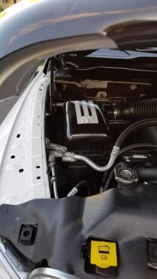

Or use the stock airbox with its cai tube, add a 3" tube to box and freeflowing filter, paint a little bling, ****.....cali carb legal... under $100
MIC DROP

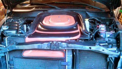

Is that scoop custom? I havent seen one like that
Yes, you could say that. I re-engineered a Vararam Air Grabber to fit my 3rd gen and made a snorkel ram air. Only the Hemi-Under-Glass is available for the 3rd gens.

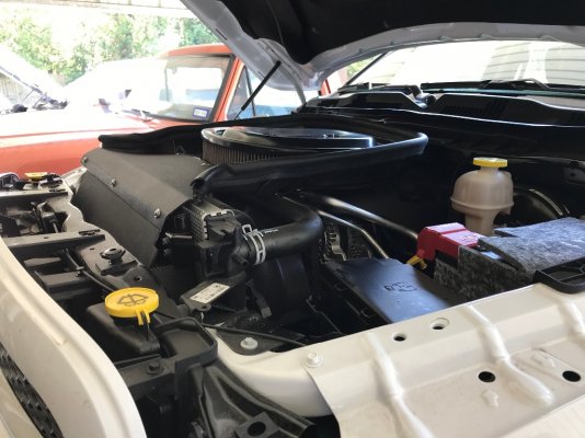

I have what RAMM5.7 has anything else is not worth the cost.
