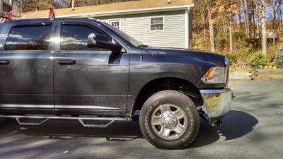

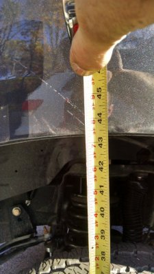

OK guys, I installed the Rough Country 2.5" level kit today and new Bilstein 5100s. Took me about 3 hours to do everything in my driveway with a floor jack, and 2 jack stands. Def not the easiest way but it's what I had. Everything went pretty smooth, passenger side spring didn't wanna seat right but finally went. Only problem I had was not kit related, but my lack of attention. While rolling on the creeper I reached up to pull myself and snapped the breather fitting off the axle body. I'll be replacing that later. Other that though, everything was fine. I'll post pics of rims and tires in a week or so, once they arrive and I get TPMS swapped over.

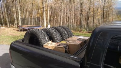

Tires and wheels showed up today, but unfortunately I have to wait until Tues to get them mounted, balanced with the tpms sensors swapped over. I hate waiting!!

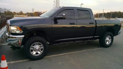

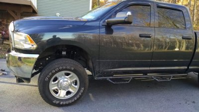

Well finally got my new 35" Cooper STTs mounted, but decided to not run my new Rockstars in the winter right off the get go. So in the Spring I'll put them on the truck and not have to worry about damaging them from road salt. So here's my truck with 35s on factory rims, 2.5" level no rubbing what so ever, not even close. Looks so much better with some mud tires and not the crappy Transforce, but I wish i could run 37's (can't with the plow)
