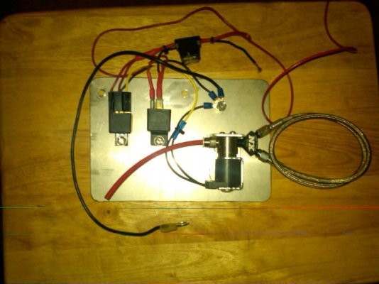

Here is a picture of the relays I used on wtr/**** setup, but they are the same as the one I used for the High Idle Mod. These can be bought at any auto parts store for around $10-$12 each. Good luck.

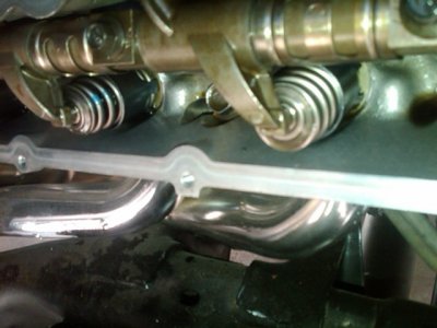

finally got a chance to take pics of valve springs-so what do you think? stock?

Those are 6.1 springs so your ok there. Next would be pushrods to check.
