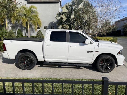

Quick confirmation needed that I've got what I need to achieve my desired result:
DESIRED RESULT: 35" white-letter aggressive tires stuffed in wheel well with no rubbing of upper control arm or other long-term damage to stock components
VEHICLE: 2017 Ram 1500 Sport 4x4 Crew Cab
STOCK TIRES: Goodyear Wrangler S-RA 275x60R20
NEW TIRES: Firestone Destination X/T 35x12.5R20
I'm not handy and I rarely go off-road...truck is my daily driver...so I've tried to do my research to determine what I need to make sure the front tires fit. Not interested in a lift kit until my kids are tall enough to get in easy. I know I need to level it and I was given 2 recommendations:
A. 2.5" Front Level Kit
B. 3" Front Level/2" Rear Level Kit
Again, not a mechanic by any means, but, if I want minimal wheel well gap, I want the 2.5" Front Level Kit, correct? I'll miss my rake as I think it fit the Sport, and I DEFINITELY don't want the front end higher than the back. Let me know if the 2.5" Front Level Kit is the way to go or whether I need to get the back end up, too.
Also, do I need spacers to avoid rubbing, or just if I want a wider stance?
THANK YOU in advance. Photo of truck recently below.

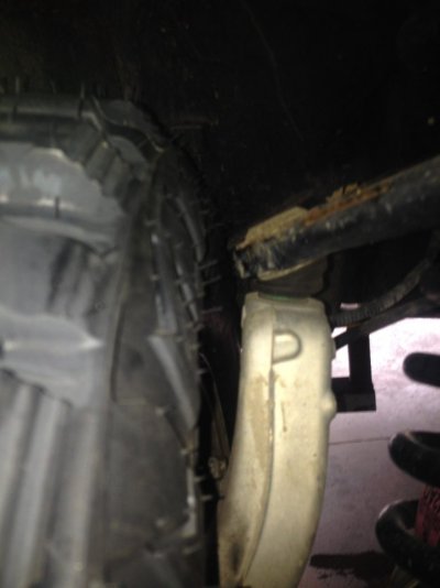

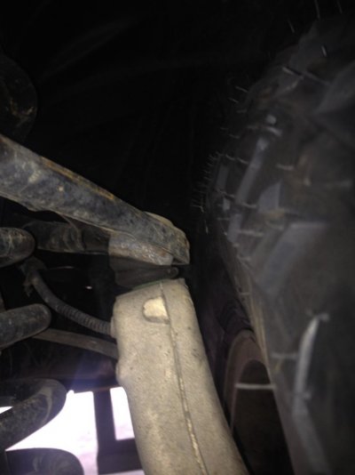

I guess it would help if I understood offset and had confirmed ahead of time whether these Firestone Destination X/Ts are going to fit on my stock rims...can anyone give me a yay or nay on that question, while I'm in the process of screwing this all up?
With the current rims you have, If you leave the stock UCA you will not rub. Now its going to be TIGHT. Picture with stock rims and 35x12.50 tires

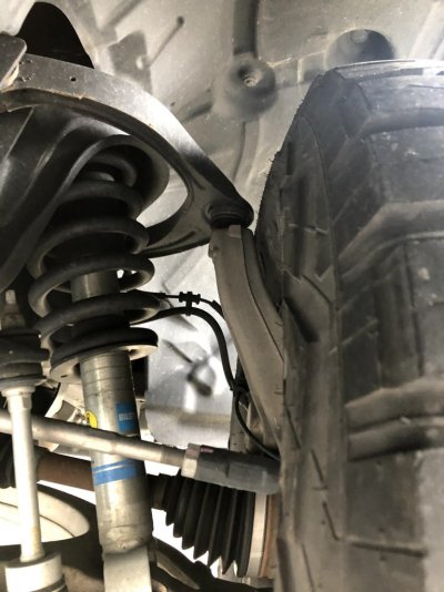

I ran a 2.5" Rough Country spacer style level kit. 0.25" spacers on the front wheels, factory UCAs. Zero clearance issues. uca2.jpguca.jpg

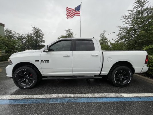

Thank you both. I ended up with an Amazon random brand 2" leveling kit and per the installer and the dealership's installer, both said I'd be fine with that, so for now, that's what I decided to go with...and so far, so good.
Fits great, no rubbing, JUST clears UCAs. I'm all highway so I'm going to run these for now and see what happens. Did not use wheel spacers, tires stick out just a tad.
Absolutely love the look; will post pics shortly, it's been raining so I haven't been able to get anything great.
