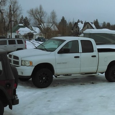

Okay, call me dumb, but I am new to owning the truck I have always wanted, A dodge ram 1500 quad 4x4. It came with a pro comp lift, I have no idea how many inches, it also came with 33's and XD 18" wheels. I would really like to run 35's on it and do a few other cosmetic things that go along with my vision for my Jewel. I am wondering if there is a way to had a few more inches to an existing lift kit?
My spouse loves to argue with me about this, because he has a 94 Chev. Silverado 1500 sb Z71 that is equipped with 35's and a suspension and body lift of 6".
Can anyone help me out?

You could add a 1.5" or 3" body lift to what you currently have.... don't know enough about the pro comp lifts if you can upgrade to get more lift or not. Sure someone will comment on that.

If you've already got it lifted a bit, the 35s will clear all the time, with exception of heavy load in rear and turning.
Can also do the body lift as mentioned.
I'm running 37s on a 99 singlecab with a flatbed and 3 inch coil spacer, and 4.75 inch block in rear for lift.
