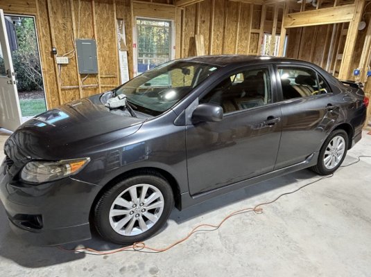

Anybody here experienced in carbon fiber wrap for vehicles?
I've been researching and this is something I'm going to do to my Corolla, just looking at wrapping the roof and hood, is 3M the best quality to use and any tips or tricks would be appreciated. Been watching a ton of how-to videos on YouTube and it ain't rocket science, but there's always do and don'ts.
