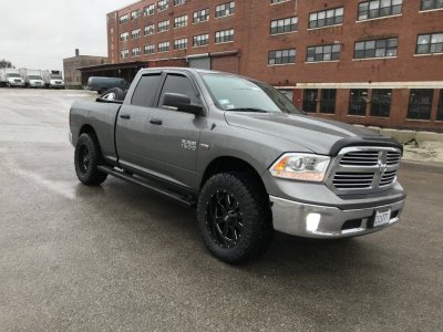

It’s time consuming but so worth it. I did this in December with my brother and it took us 5 days to do it. Definitely don’t do this in direct sunlight

Did you wrap the whole truck in that New Holland Blue or just the bumper and grill? Looks nice man.

The whole truck was wrap in smurf blue, this is the original color

My bad. That's looked like the Holland blue. That's freaking awesome though!

I just purchase a white sport hood and wrapped that As well. I love wrapping things lol. If u get bored of the color just peel it off and start with something else
