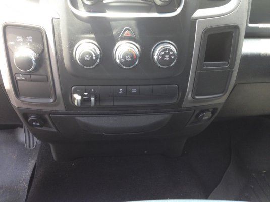

Anyone tried putting a cobra 29 in the spot where the tray comes out from the center console?
Not sure which tray you referring to.
But I had found a picture of an install someone did ,that they put a smaller CV (not sure of the model) in the tray area directly below the heated and cooled seats button area . Where the vertical part meets the center console. The one that nothing really fits in.

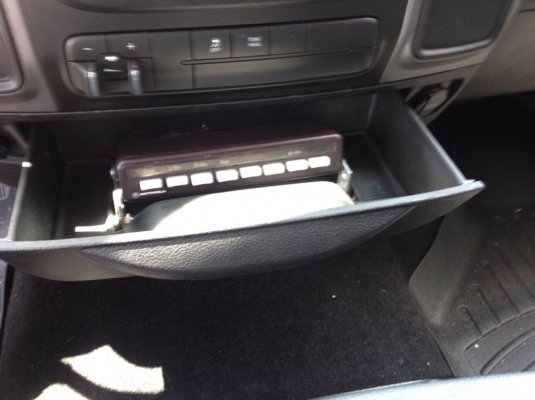

You mean this tray?
I don’t have a CB but that’s where I put my switches.
crash68
ACME product engineer
Mar 20, 2016
12,333
21,423
3.0 EcoDiesel
Can it be mounted on the passenger side ?
I don't know, as I don't have this mount. I've seen it mentioned in other threads and forums for people looking to install a CB. I would imagine it could be possible, drop the manufacturer a email. I wonder if the stock antenna would interfere being so close?

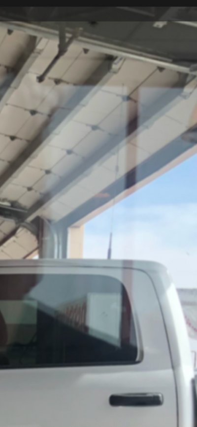

So to answer a few questions, as I’ve been a licensed Amateur Radio Operator for the last 15 years, and have been helping my Father and Grandfather install radios in trucks/cars for the past 30 years.
First, the engine noise is the electrical whine of the alternator and the ignition system being transmitted through the wiring. Even if you go direct from battery to the radio you need a noise filter. Google 12v 20amp noise filter and anyone will solve that problem.
Second, radio choice is just that, your choice. It all depends on what you want to do/use it for.
Lastly, antenna choice and placement. The best place for any antenna is on a flat metal surface. It gives you a good ground plane and allows you to hear and talk farther. Height is also one of the most important things for antennas. Without getting into too much engineering the center of your roof is the best place, and it permanently attached is best. But everything is a compromise. I drilled a hole just in front of the third brake light on my truck to mount my antenna. Works great for what I need it to do.
Currently only picture I have of antenna. I will take some more today. After I get my ass out of bed.
