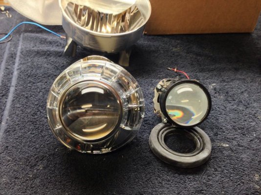

Here's a picture of the LS460s next to a Mini that I normally use. Now, keep in mind.........the mini is shroudless there. Lens size, 3" vs 2.5" (just to give you an idea).

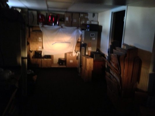

And here's what we started with for light output on these Chally's

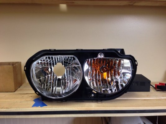

The hole I cut to mount these....

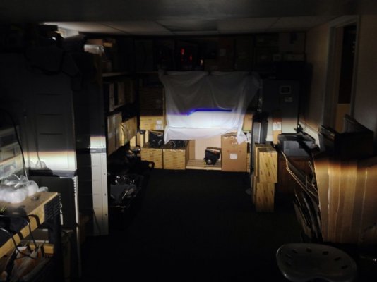

and output from the LS460s

What makes these different from a set of the Mini's you usually use? Just a better distribution of light, or better at focusing the light where it needs to be, etc.

Yeah, pretty much. Bottom line, they were designed to have a VERY wide beam of light, just a superb beam.
