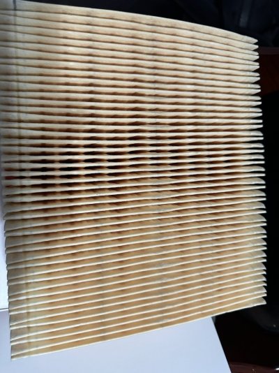

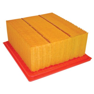

What air filter are you using the 2019 an newer trucks takes a different air filter than the 2018 an older trucks and that can cause regen problems, so go take a look at your air filter if it looks like the first photo below its the correct one, if it has glued pleated like the second photo its the wrong air filter.. If it has the correct air filter do you do a lot of in town stop & go driving or use diesel fuel that contains 20% bio diesel or were you don't get the truck out on the hwy for long enough drives for it to do passive regens?

As 06 Dodge says, most auto stores and the internet still sell the wrong air filters for these trucks. I was troughing a P0299 turbo underboost code. The dealer tried to fix twice then saying they needed to put a new turbo on it. When I took it in for the new turbo, the tech found that the pleated filter with glue strips was most likely the issue. I replaced it and have not had the code come back since (10k mile+).
