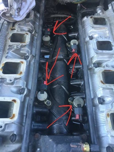

It is the MDS Solenoid, not a sensor. It opens to allow oil pressure to collapse the lifters when activating MDS mode, and shuts off the oil to reengage the lifter. You'll need to remove the fuel rail and intake manifold and the foam insulator to get at it.
#1 is the bottom right
Yours may be different as this is from a 2013-2015 manual, but i doubt it is significantly different.
