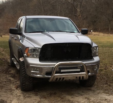

If I remember correctly(it was a gift from my wife), the bar was right around $100+- .
The original mounting instructions have the bar coming out under the bumper, which required cutting(or in my case, removing) the air dam/chin spoiler. When I built the mount for my winch, I incorporated new mounts for the bar to raise it to the middle of the bumper.

Looks great!!!
