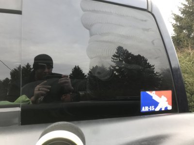

My goal is to not get water spots etched into the glass again so I’m looking to do some type of coating or long term sealer. I don’t have a garage so my truck lives outside I do keep up with a weekly wash as much as I can. Recently I’ve been using p&s bead maker as my sacrificial layer on all surfaces and it does its job but I’d like to spend less time on the glass.
Now that I have ceramic coated my wheels I feel like I have seen the light and am hoping I can have similar maintenance on the glass.
After I polished the glass i wanted to lock it in, because it looked perfect. Now that the weather is consistently above 45-50 here in PA I can polish again and use a product on it that will keep it for a while.
