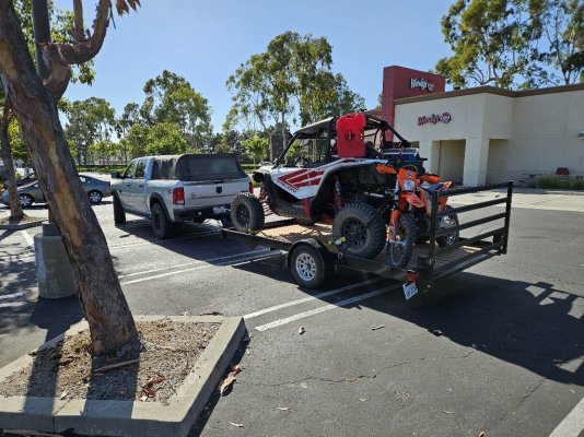

You can also buy a SXS and and you can haul it with your truck you just need to buy a trailer, full on offroad experience :) Not cheap either but hey. Check for example Kawasaki KRX 1000, you can run 35's on that one literally stock. Not all SXS's can run 35's stock and that world is another one that has its own niche with crazy prices, so if you choose SXS do a reasearch on what trails you want to run. I have a Talon 1000R, and is not a rock crawler, more of trail rig for me. I started pricing down gearing for 35's, or control arms and skids for rocks and F...K those prices. i'll mod my Jeep Wrangler any day of the week over modding my SXS. Much more planted doing this type of things

Now days the truck is just hauling the family as always and or trailering the offroad toys, but when i drop the trailer i'll use it as well to chase my kids down in the desert through washes and the like.
