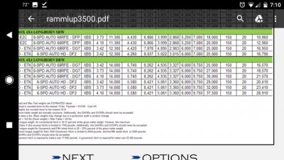

According to this. And this is for a 4wd 2013 larmie you should have 5580 payload and towing of 23413. So you should be just fine
